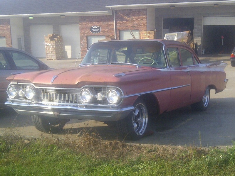

Post by ProCroation » Sat Aug 24, 2013 1:37 pm
This is my 59 Olds Dynamic 88. Matching numbers 371 Rocket came with the car as well as matching trans.
It's the original paint, original rust, and interior minus the newly welded in floor pans. Everything on it works down to the radio/lights. Between this and my motorcycle build I stay busy.
Instead of starting a bunch of new threads I will keep all my vehicle pics and stats contained in this one thread. I'd hate to clutter the board

Nice car.

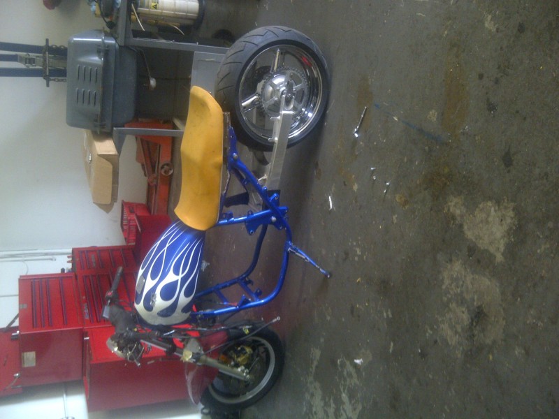

Post by ProCroation » Sat Aug 24, 2013 1:56 pm

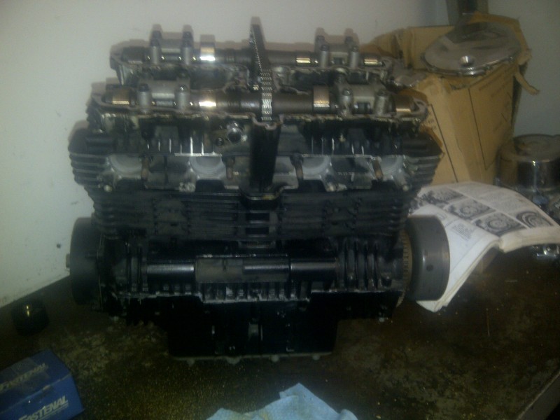

This is my bike build. It's an 81 Kawasaki KZ1000 J model (california highway patrol engine),
Dome Pistons 20 over/machined rods
New machined crank (welded and balanced)
MTC388 cams w/adjustable sprockets
Machined jugs 20 over
Ported head w/ new valves & springs
Barnett race clutches
Dyna ignition
92 Suzuki Katana forks, handlebars, brakes, wheel, fender
92 Suzuki Katana rear swing arm
02 Hayabusa rear wheel and brakes
77 Kz900 tail
Custom upholstered seat by Pauls Upholstery. The yellow foam seat pics were taken before the upholstery work
The flames are leaving. The entire bike will be House of Kolours Oriental Blue with silver flake and Orion Silver basecoat. It will all be the same blue you see on the tank. It has been dubbed "Kawtana"

Kz1000 j model engine

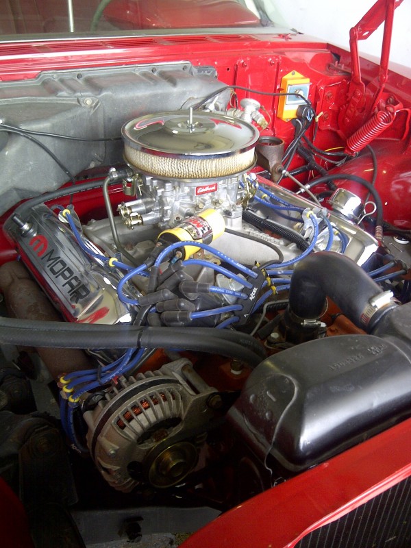

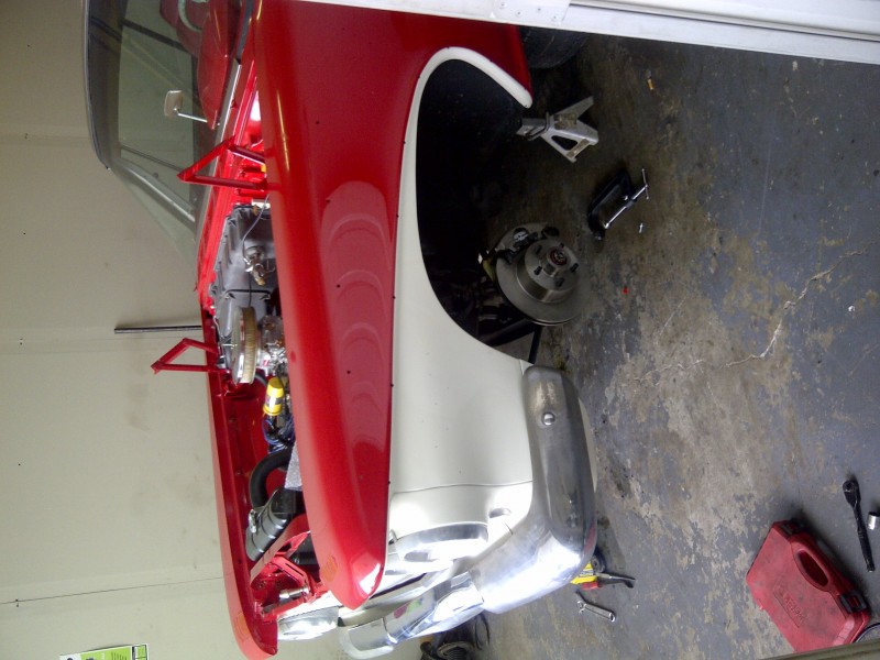

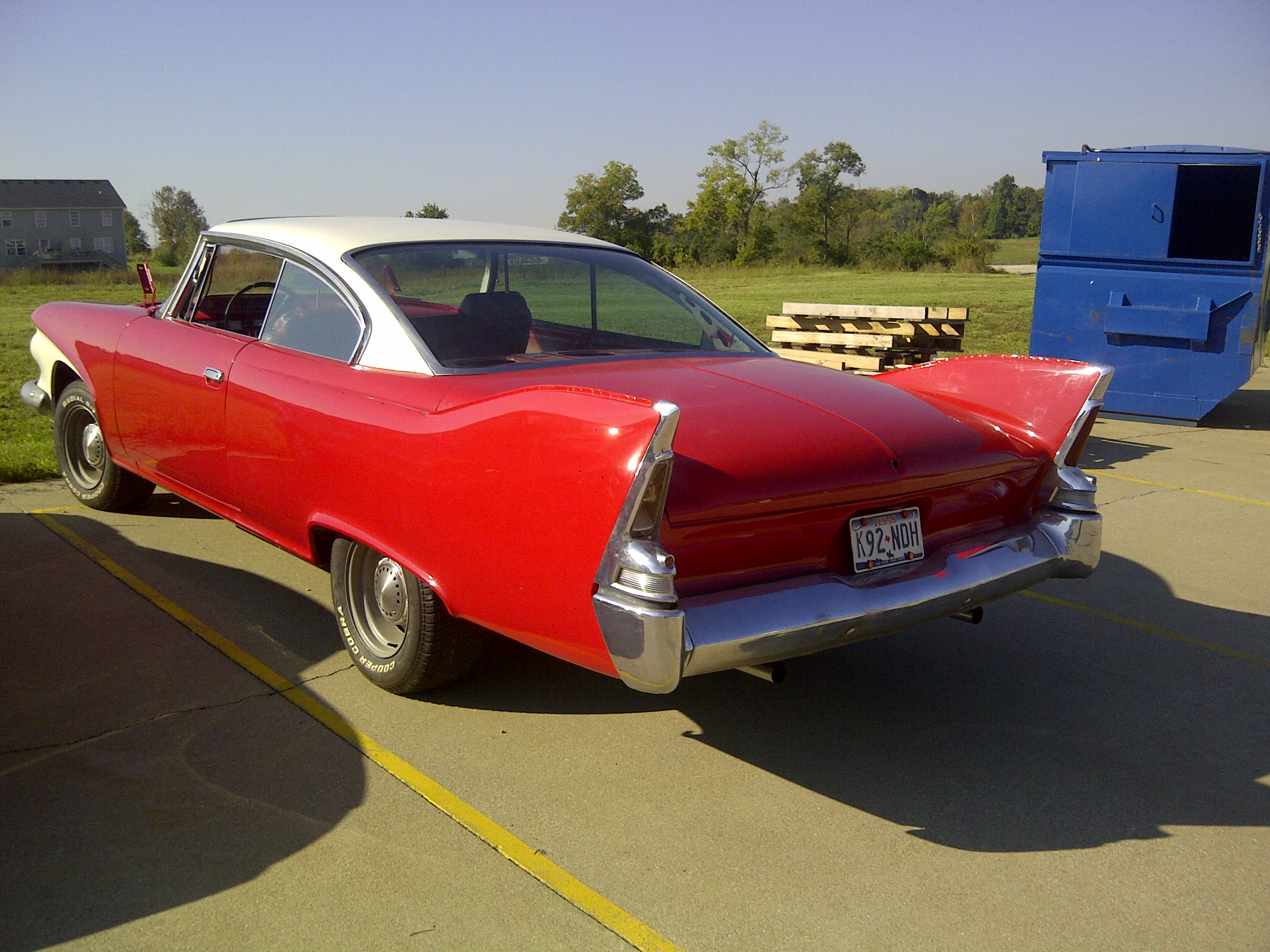

Post by ProCroation » Sat Aug 24, 2013 4:14 pm
Plymouth Fury I converted to disk brakes 6 months ago for a friend. Can't remember the year but was a fun project. Not mine but still worth sharing. 413 big block.

I like the olds. What's the future plans?
Re: My work in progress
Post by ProCroation » Sat Aug 24, 2013 11:43 pm
Future plans included car shows and possibly a profitable sale. We will have to see how money goes.
Here's more of the Fury

Post by ProCroation » Sat Aug 24, 2013 11:44 pm
Last pic of this car...

Though that Fury is a sweet ride too.

The Plymouth is a '60 I believe.

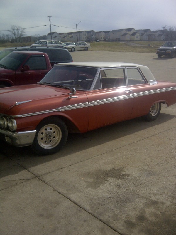

Post by ProCroation » Sun Aug 25, 2013 1:19 pm
Same friend, different car...literally different. See if you can spot what makes this baby odd... :)

Post by Joe » Sun Aug 25, 2013 4:00 pm
4.6 Engine

Post by ProCroation » Mon Aug 26, 2013 3:01 am
Joe wrote:4.6 Engine
Winner. ;)
The Galaxy is a blast to drive. So smooth, no cold start issues...quiet.
Granted I love a cam thumping monsters, this car is just fun. By now you can see my friend has the cool cars and I mainly live vicariously through his toys. I snap pics whenever I have time involved in them.

Ding. They removed the tailfins for `61
