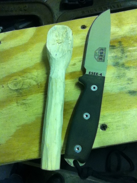

Re: Week 5/ The spoon
Post by mtmetzger » Mon Mar 11, 2013 2:19 pm
Looks like a great start to me!
Post by 86 slo-vo » Mon Mar 11, 2013 2:57 pm
The actual cup of the spoon is a bitch, what are you guys using for this?
Post by son of liberty » Mon Mar 11, 2013 3:38 pm
86 slo-vo wrote:The actual cup of the spoon is a bitch, what are you guys using for this?
Just like the making of the spoon is a universal so is your question....lol
Someone one here mentioned the method of burning it out spoon. I used a swiss army knife to make mine, I used the smallest blade to cut a series of grooves then pry the slivers left out until it was as deep as I could effectively get it. you could cut a single groove down the center and then widen it until its the size you want. Overall its sheer determination and a constant effort.
It gives you a whole new respect for some of the spoons people make, look online and you will see strait up works of art, but for us for the most part , we can settle for a functional spoon.
Post by nemo » Mon Mar 11, 2013 7:55 pm
Is it too late to start hating SOL? I'm using a shaped and modded broken knife as a spoon gouge along with sandpaper. The bowl is shaped and almost finished. The layout is down and the roughing out will have to wait till tomorrow night. Here's what I got so far.
