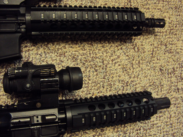

Saturday I was able to get out to the range. I took both my 7.5 AR pistol with Kinetic Cone Brake and my 10.5 with Standard A2 Hider. Both were accurate at 50 yards using red dot optics. I didn't see any real difference with the two brakes as I would have thought. I even exchanged them on the two uppers, but didn't feel much of a difference. What did work for me was using a H2 buffer. Firing the pistols felt smoother with the heavier buffer.
I was able to hit bowling pins and pop cans at will up to 50-60 yards. Both cycled fine with PMC brass, wolf steel and Federal ammo. Was able to find the uppers complete for $350 with rail and bolt on ARFcom and quality was fine.
So in the end I didn't see much difference firing 7.5 or 10.5 inch barrels. Both are loud as heck and throw large fire balls. :lol:
Next wrote: I bought the one below. It is only 2.25 inches.
http://www.kineti-tech.com/steel-muzzle ... ave-ports/
