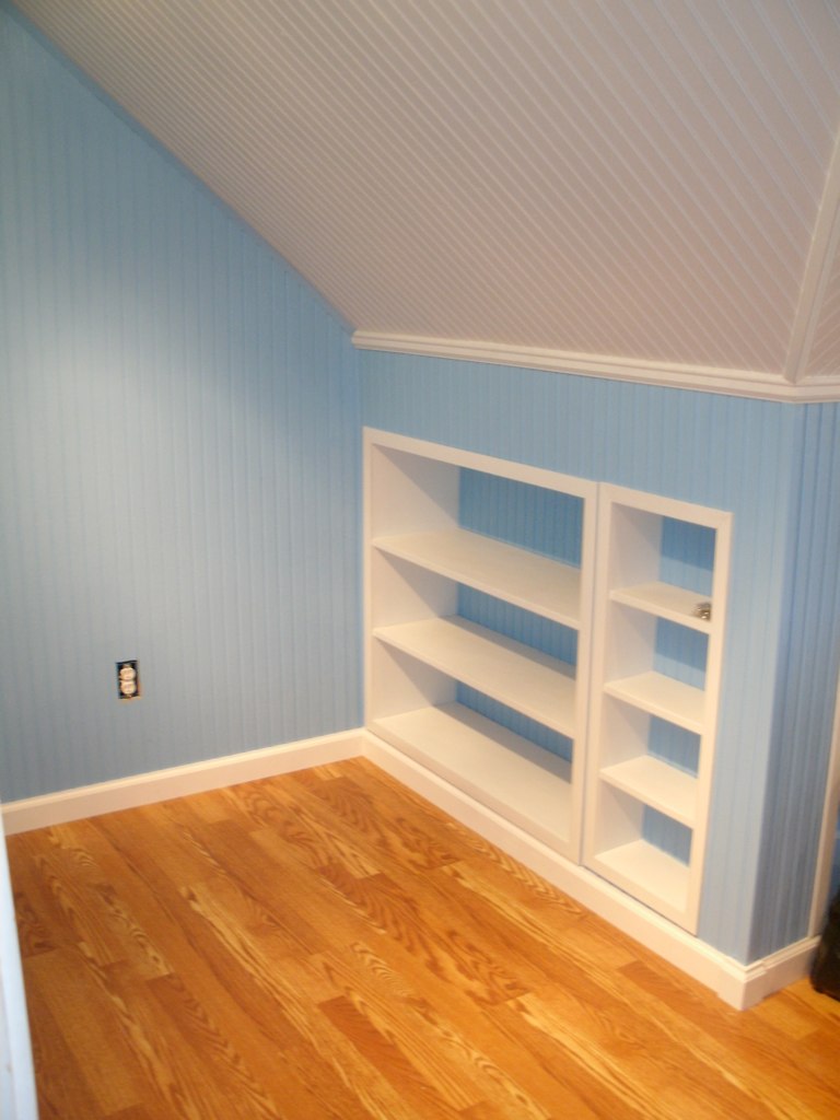

Re: Anyone on here installed laminate flooring?
Post by Livewire » Mon Jun 25, 2012 4:46 pm
First two pics are the same flooring. The light makes it look different. The last one is a different type.
