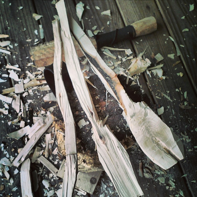

Oh! I do believe this Wyldman maple is gonna bear some nice spoons.

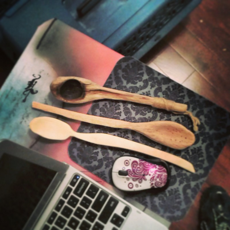

Firewood spoon #1, firewood spoon #2, green maple spoon!
Getting more elegant every day, and the time required is getting exponentially shorter. This one was 2 hours total, including hatcheting, carving, #100 grit smooth sanding, a steel wool burnish, and a mineral oil finish. The bowl is a bit on the shallow side, still need me a hook knife. Wyldman suggested a farrier's knife... need to look into that... Nice meeting you, too, Sir.
Now to dry it out slowly in a paper bag, and hope this one doesn't split on me. ;)

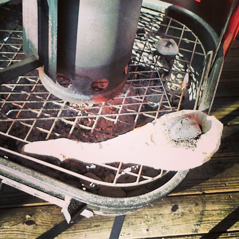

Having problems working this first ladle...
Tried the burning-out-with-hot-charcoals method again, but developed a crack:
Then decided I'd pick up a farrier's hook knife from Tractor Supply, to carve out the rest of the bowl. Didn't work. Snapped the blade inside 1 minute! Cheap $14.99 P.O.S Think I'll drill-press out the bowl, and use the snapped knife to chunk out the remaining bits before sanding smooth ;)
Oh! Also snapped off the ladle handle, but I've a remedy for that. Plan to splint a rod of wood onto the stub, superglue, and wrap it in twine.

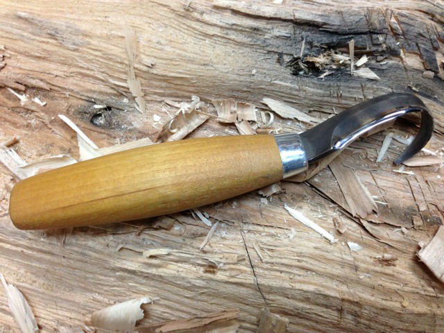

My new Mora spoon knife just arrived in the mail, and it's dull as Rosie O'Donnell. Can anyone put me some knowledge on how to sharpen a spoon knife?

Post by fromkentucky » Thu Aug 08, 2013 12:44 pm
HE'S ALIVE!!!
...Anyway, try here or here.
"A citizen may not be required to offer a 'good and substantial reason' why he should be permitted to exercise his rights. The right's existence is all the reason he needs."
-U.S. District Judge Benson Everett Legg
Wooden Spoon Thread 2.0
Post by nemo » Thu Aug 08, 2013 12:49 pm
This is the method I use. 600, 800, and 1200 followed by strop. I get good results.

Post by Kadnine » Fri Aug 09, 2013 12:26 pm
Thanks, guys! That's a big help.
