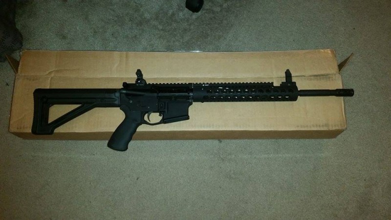

Got the Radical upper in. Fit and finish look good, but only a trip to the range will tell if she'll run well or not. So far I cant complain. :D

Just thought I would post an update about my experience with the RF upper. It seems to be short stroking. It ejected fine, but most of the time it wouldn't pick up the next round. The few times that it did pick up the next round, it failed to feed all the way into the chamber and jammed. I ran it on a Bushmaster lower assembled by me (no expert), a PSA factory lower, and a Colt LE6920 lower. Also tried 10, 20, 30rd magpul Pmags, 30rd GI mags, and 30rd Lancer L5 mags. Same problem despite the combination. Will be contacting the company I purchased from tomorrow to get the issue resolved.
